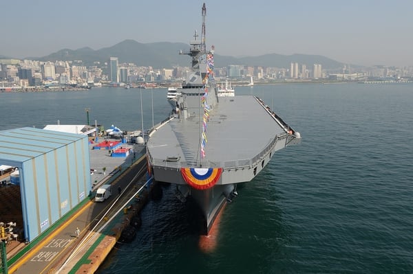

The 3.07-meter-long K-SAAM is scheduled to be fitted on the 14,500-ton amphibious landing ship Marado. (Courtesy of the South Korean Defense Acquisition Program Administration)

The 3.07-meter-long K-SAAM is scheduled to be fitted in new FFX-II/III frigates and the second 14,500-ton amphibious landing ship, named Marado, which was launched in May. The missile is to be housed in a four-cell vertical launch system, four of which are intended to be fitted to the warships, providing 16 missiles per ship.
